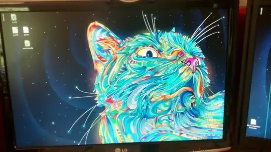

  • All windows open on top of each other in the top left, have no menu bar and can't be moved. I don't think I can change focus between windows.
    Running the command unity flashes up the UI but it then immediately crashes(?)
  • Going into ccsm and disabling some bits didn't change anything.
See the image below - I can just see my desktop and the background. I can click with the cursor. enter image description here
Reinstall ubuntu-desktop and unity from a virtual console.
sudo apt-get install --reinstall ubuntu-desktop unity
That should fix it. Sometimes corrupt packages come through so you should reinstall them.
