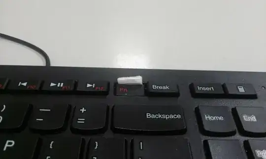

Hi I have a problem with my new USB Lenovo keyboard, I can't (don't know how) switch Fn keys in Linux, on windows it was very easy.
But I don't know what I can do on Linux to switch Fn keys (or disable), do you know any solution? I need standard functions of F1 through F12...

this is the best solution what i found ;-)
I found a software solution.
clone the following program from github:
git clone https://github.com/lentinj/tp-compact-keyboard.git
compile to following program:
cd tp-compact-keyboard/tp-compact-usb-keyboard
make
sudo ./tp-compact-usb-keyboard /dev/hidraw1
Maybe some errors are shown when you execute the program.
This program sent 2 keystrokes to the keyboard (0x05 and 0x01).
i think, you can't press them physically:
http://www.kbdedit.com/manual/low_level_vk_list.html
They are mapped to special keys.
this is only a temporary solution - after a reboot this settings are gone.
maybe you create a cronjob to fix it permanently:
http://www.cyberciti.biz/faq/linux-execute-cron-job-after-system-reboot/
