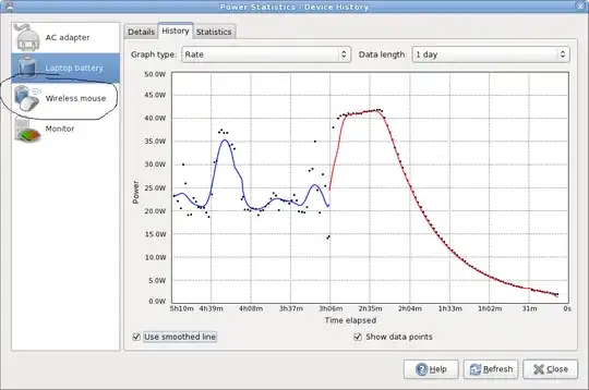

From the GUI, mate-power-statistics (from the MATE Power Manager project) or gnome-power-statistics (from the GNOME Power Manager project) can do this.
gnome power statistics

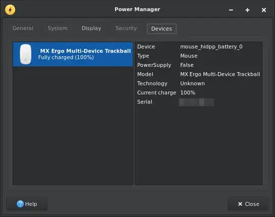

As snowball pointed out, there is upower --dump, which works great for my MX Ergo (is shows 100% (should be ignored), which is a bit confusing, but it just came from the charger).
On Xubuntu/xfce, there is also the graphical tool xfce4-power-manager-settings with the devices tab. although, it doesn't have statistics, like the gnome or mate tool:
Power Manager, Devices tab
