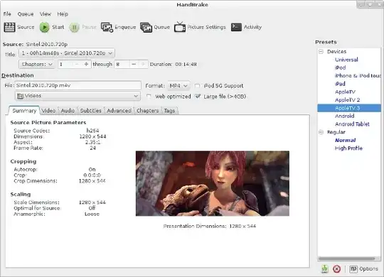

Another pretty easy to use is Handbrake
To install in ubuntu:
sudo apt-add-repository ppa:stebbins/handbrake-releases
sudo apt-get update
sudo apt-get install handbrake
