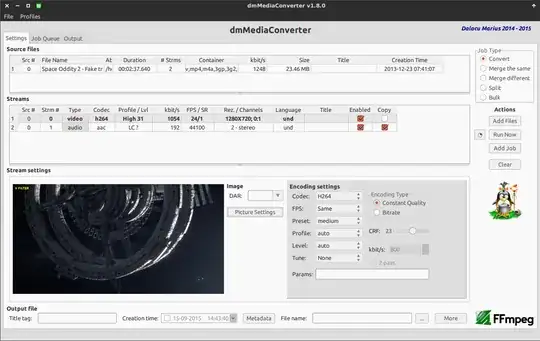

dmMediaConverter is a crossplatform FFmpeg frontend (GUI) exposing some of its features. It is intended to be simple and easy to use but also to be able to achieve complex tasks. I have inspired myself from a lot of media converters like Handbrake, WinFF and MkvMergeGui. One feature was lacking from most of them, video stream copy (pass-through), that made me build this.
You can do a lot of stuff (extract audio, crop, split, merge, burn subtitles, watermark, scale, bulk convert, etc) with it so check it out:
http://dmsimpleapps.blogspot.ro/2014/04/dmmediaconverter.html

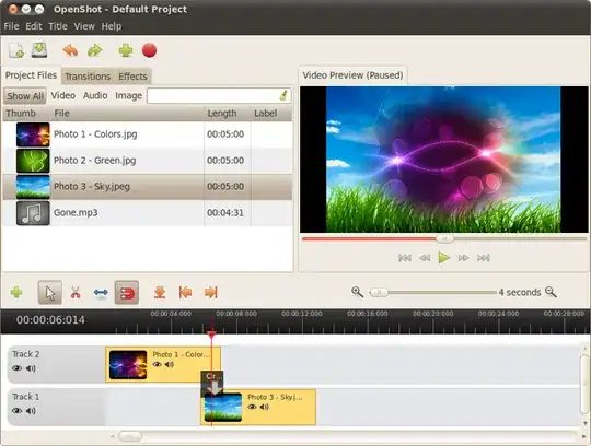

Try Openshot.
sudo apt-get install openshot
Here are the features of Openshot software:
   Support for many video, audio, and image formats (based on FFmpeg )
   Gnome integration (drag and drop support)
   Unlimited tracks / layers
   Clip resizing, scaling, trimming, snapping, and cutting
   Video transitions with real-time previews
   Compositing, image overlays, watermarks
   Title templates, title creation, sub-titles
   3D Animated Titles
   SVG friendly, to create and include vector titles and credits
   Scrolling motion picture credits
   Solid color clips (including alpha compositing )
   Support for Rotoscoping / Image sequences
   Advanced Timeline (including Drag & drop, scrolling, panning, zooming, and snapping)
   Frame stepping (key-mappings: J, K, and L keys)
   Video encoding (based on FFmpeg )
   Key Frame animation
   Digital zooming of video clips
   Speed changes on clips (slow motion etc)
   Custom transition lumas and masks
   Audio mixing and editing
   Presets for key frame animations and layout
   Ken Burns effect (artistic panning over an image)
   Digital video effects , including brightness, gamma, hue, greyscale, chroma key (bluescreen / greenscreen) , and over 20 other video effects
   OpenShot provides extensive editing and compositing features, and has been designed as a practical tool for working with high-definition video including HDV and AVCHD .
See here : Main Web-site

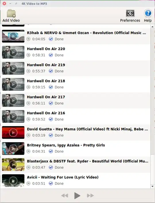

4k Video to Mp3 Best suit for me.
https://www.4kdownload.com/products/product-videotomp3
and the advance of this piece of app is it do multiple converts concurrently very fast.and it applies a random album art to the Mp3 captured from the video.
