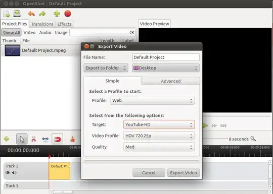

As an alternative, can I suggest you use OpenShot to edit video and also upload HD quality video to Youtube.
You export the video similar to this picture.

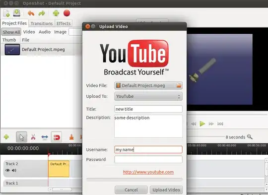

You can then use the inbuilt upload feature to send to Youtube
