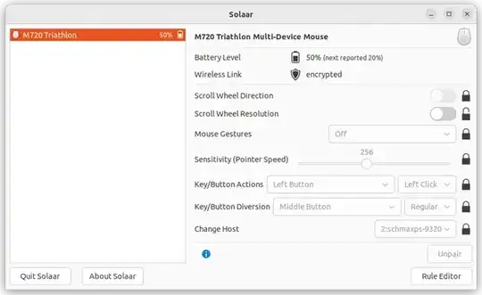

For Solaar users, the trick was to turn off Scroll Wheel Resolution, i.e. "High-sensitivity mode for vertical scroll with the wheel".
Solaar
