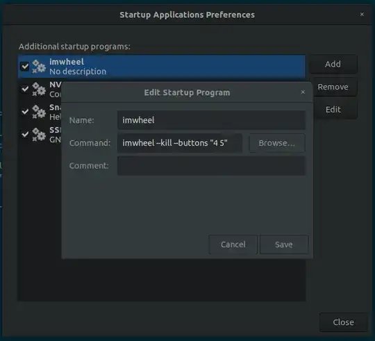

Then add imwheel --kill --buttons "4 5" as a startup application:
startup screenshot

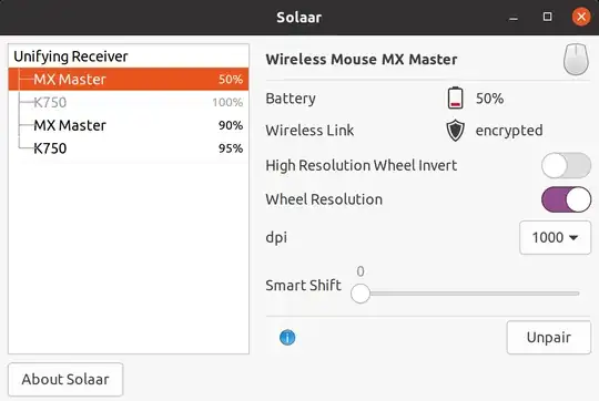

However, I have a Logitech Wireless MX Master mouse and use Solaar (v1.0.1) to configure it. When configuring the mouse in Solaar, I can select "Wheel resolution" which gives me a much better and faster floating scroll experience.
screenshot of Solaar configuration
