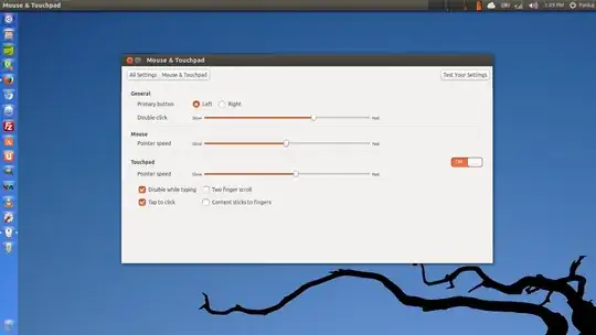

Actually go to System setting - mouse and touchpad and you will get a window like Mouse and Touchpad
in this the middle option pointer speed the option for sensitivity .
