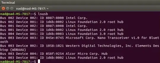

lsusb when the mouse is working perfectly
lsusb output in terminal

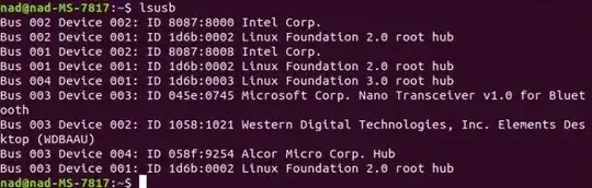

lsusb when it's not working, when booting Windows then Ubuntu
identical lsusb output
