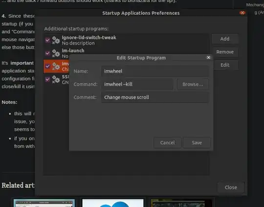

6 - Set it start with ubuntu
Open Startup Applications
Screenshot of Startup Applications Preferences with Edit Startup Program dialog opened for imwheel
Put these texts into input boxes,
That's all
more info here

According to an answered question on AskUbuntu (this question is similar), you can
  1. Open Apps -> Startup Applications.
  2. Add a new entry to the bottom of the list: Name= Wheel Scroll Speed , Command= imwheel , Comment= Activates wheel scroll speed fix on system startup (or whatever you like)
See link How can I adjust the mouse scroll speed?
