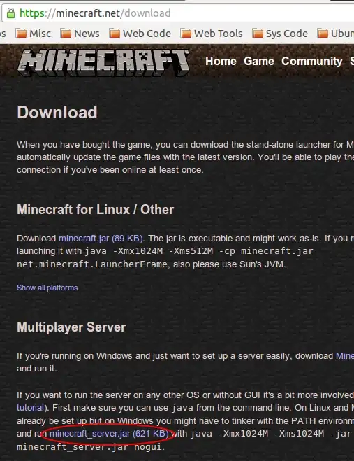

To create your own server, first download the executable minecraft server
Direct Link HERE
