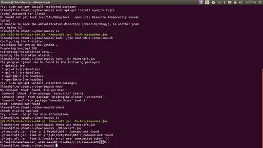

I am trying to launch Minecraft.jar and I cannot make it boot as an executable. I have gone into the properties and set it to executable, and I have installed jdk-7u55-nb-8-linux-x64.sh with and without superuser. I do run a x64 computer. I recieved the file from the website here. I have tried ./Minecraft.jar and java -jar Minecraft.jar
Output of java -jar Minecraft.jar
The program 'java' can be found in the following packages:
 * default-jre
 * gcj-4.6-jre-headless
 * gcj-4.7-jre-headless
 * openjdk-7-jre-headless
 * openjdk-6-jre-headless
Try: sudo apt-get install <selected package>
Output of ./Minecraft.jar
./Minecraft.jar: line 1: $'PK\003\004': command not found
./Minecraft.jar: line 2: $'\b\b\222t\354B\002': command not found
./Minecraft.jar: line 3: syntax error near unexpected token `)'
K-*��ϳR0�3���M���u�I,.�R�K-����KM.JL+�K��/).)J,�s��x�x�PK'K-.

llamah
  • 57
You need to download java or jdk 6 in software center. When downloaded right click on minecraft.jar ang go to its settings and allow it to launch as a program
