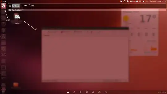

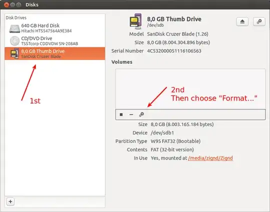

You can use Disks. It's installed by default and easy to use.
Disks application appears in Dash search
  • Click on the Dash icon
  • Search for "Disks"
  • Click on Disks
The application will show up:

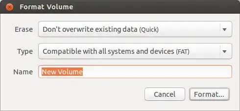

choose device in Disks interface left bar
  • 1st: Choose the USB flash drive
  • 2nd: Click on the "gear" icon and choose "Format"
This little window will appear, just choose the option you want and click on Format:
Erase option, filesystem type option, and Name field shown in Format Volume dialog

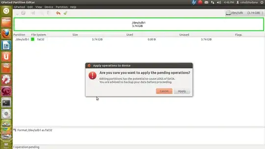

Use GParted
GParted screenshot

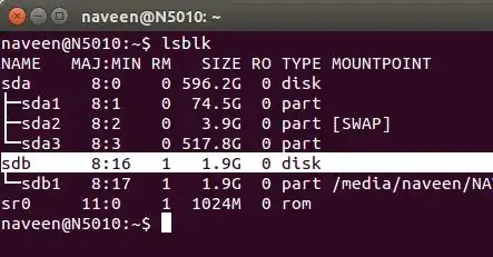

  1. Open the Terminal (Ctrl+Alt+T)
  2. List your block storage devices by issuing the command lsblk
    Then identify your pen drive by it's SIZE. In my case its /dev/sdb

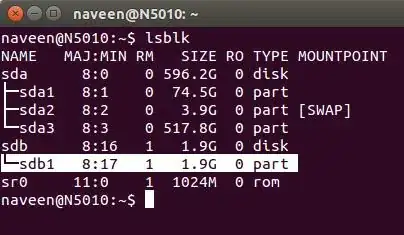

    • See your new partition label with the command lsblk
      In my case it is /dev/sdb1. Once again pay attention to this name as there will not be any protection to prevent you to erase an other disk.

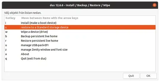

Restore a USB drive to a standard storage device
Install and use mkusb (mkusb-dus), which can format alias restore a USB drive to a standard storage device (with an MSDOS partition table and a partition with the FAT32 file system). These instructions are also relevant for other drives (memory cards, hard disk drives, HDD, solid state drives, SSD).
If you run standard Ubuntu, you may need an extra instruction to get the repository Universe. (Kubuntu, Lubuntu ... Xubuntu have the repository Universe activated automatically.)
sudo add-apt-repository universe  # only for standard Ubuntu
sudo add-apt-repository ppa:mkusb/ppa # and press Enter sudo apt-get update sudo apt-get install mkusb mkusb-nox usb-pack-efi
See these links with more detailed instructions,
mkusb version 12 alias mkusb-dus: enter image description here
mkusb wipes the first megabyte as a first step of restoring it
Sometimes some data are 'tricking' the software to think that the pendrive does not work, even when it is good, and it is enough to wipe the first megabyte to get rid of those data. You may 'look at' the drive with a tool, that does not recognize or understand correctly the structure of the boot system, for example if it was cloned from an iso file.

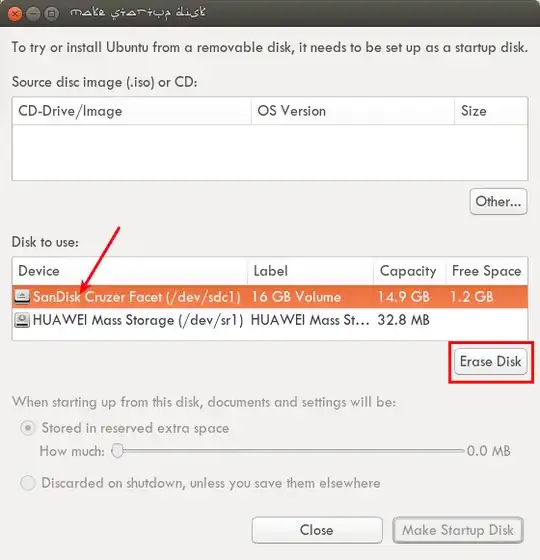

I use Startup Disk Creator, installed by default, to format my USB drives.
  • Open up 'startup Disk Creator' by searching for it in the dash.
  • Insert your flash drive, it will be detected automatically.
  • Select it (in case you have more than one)
  • Press 'Erase Disk'
See screenshot below:
