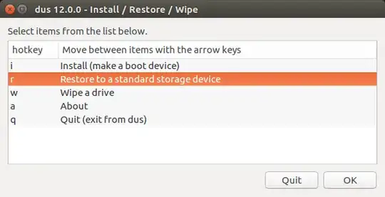

An easy and safe method is to restore the USB pendrive to a standard storage device with mkusb. It will wipe the current partition table and create an MSDOS partition table and a partition with a FAT32 file system.
See the following links,
help.ubuntu.com/community/mkusb
help.ubuntu.com/community/mkusb/wipe
There are more details at this link,
Restore a USB drive to a standard storage device
