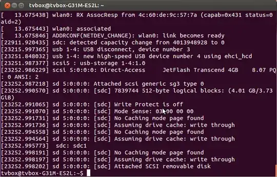

2) Open a terminal and issue the command dmesg
you should see your device name listed at the bottom like this: mine is /dev/sdc. yours may be different. Use the /dev/sd? entry that you see. I will use /dev/sdc.
ff1
3) If your device is preformatted like mine the system will automatically mount it and you will have to unmount it with the command sudo umount /dev/sdc1

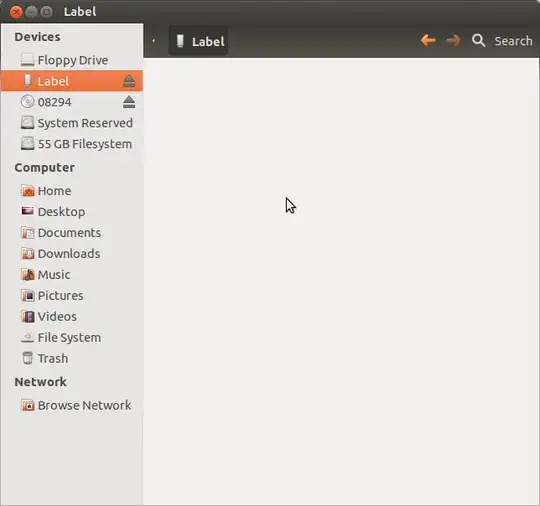

5) When the command has finished, you can simply unplug the drive and plug it back in. The system will recognize it and it will show in your file manager like this:
ff3
