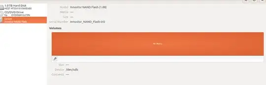

Ubuntu is not detecting my USB drive as a mountable volume, but it is showing in Disks, as seen in the below screenshot:
What can I do to format this drive?

From your screenshot, it seems as though your drive is just toast and no longer works (note the No Media message).
Unfortunately, this most likely means that it's time to buy a new flash drive.
