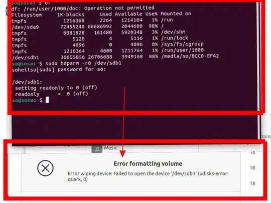

My USB have had many files with write protected permission and those are some Trojan, so I have tried the belewo methods :
sudo hdparm -r0 /dev/sdb1
/dev/sdb1: setting readonly to 0 (off) readonly = 0 (off)
and tried this instruction:

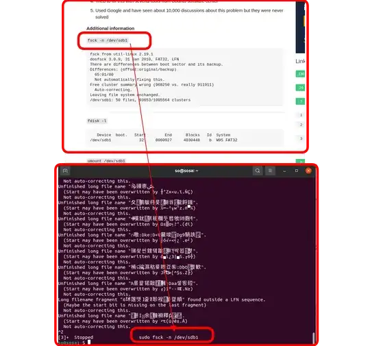

sudo fsck -n /dev/sdb1
And get the below result which is taking many minutes for ending and I stopped it by pressing ctrl+shift+z, which could be seen at here with more details:
So I asked here for finding some way to format this strange USB drive.

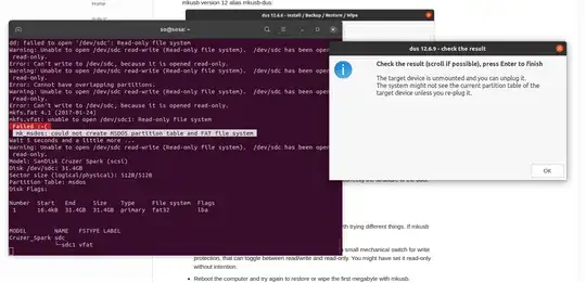

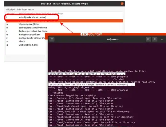

based of 4th comment, I have tried to use the mkusb as said at here:
But it has been failed and get the below errors (more information could be seen here):
Also, the mkusb has failed in formatting the USB flash by selecting the first option, as you can see below: enter image description here Thanks.
