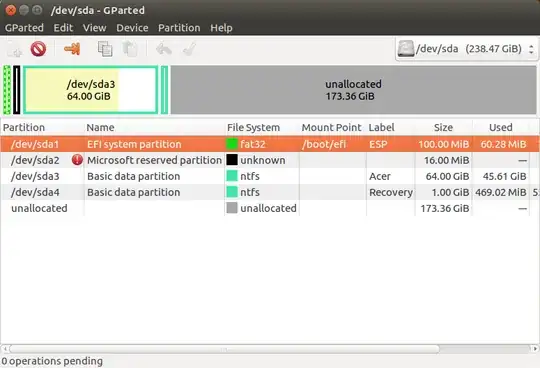

Probably your partition table is corrupted. The easy way to move forward is to open gparted and and in the top right go to /dev/XdYand select the disk you want to edit:
This will destroy everything on the USB stick!
  1. Go to the menu Device
  2. Then Create Partition Table
  3. Then msdos
  4. Press OK
Now you can create new partitions the way you want them...
If the above fails: Your USB stick is toast! Throw it away and buy a new one!
