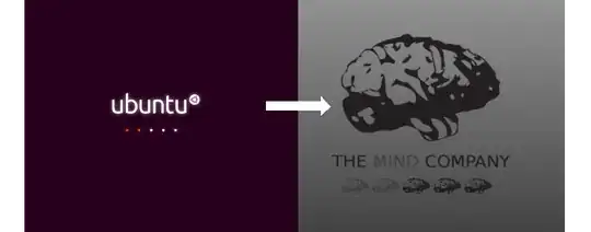

Use your image editor of choice to alter the png images. I like GIMP for quick edits.
Here is an example of my alterations:
screenshot screenshot screenshot screenshot screenshot screenshot
