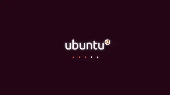

After I installed "kubuntu-desktop" my loading screen was changed: default ubuntu loading screen

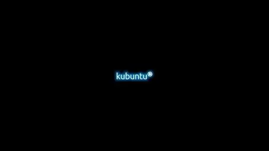

to this: kubuntu loading screen
How do I change it back?

You can do this using the update-alternatives command. You'll need to do this twice -- once to select the graphical boot splash, and once to select the fall-back text boot splash.
Open a console window and run:
sudo update-alternatives --config default.plymouth
Enter the selection number for the line containing ubuntu-logo.plymouth.
Next, run:
sudo update-alternatives --config text.plymouth
Enter the selection number for the line containing ubuntu-text.plymouth.
Finally, update your initramfs. Run:
sudo update-initramfs -u
Reboot your PC, and you should see the Ubuntu boot splash return.
