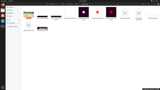

at line no. 192 logo.jpg is the Image of my interest and its location must be /usr/share/plymouth/themes/ubuntu-logo/ as described in this file /usr/share/plymouth/themes/ubuntu-logo/ubuntu-logo.plymouth
