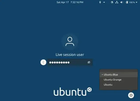

  1. I type my password and press Enter on the GDM login screen:

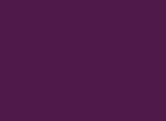

  3. Then I briefly see this purple background

(1) GDM Screen... enter image description here

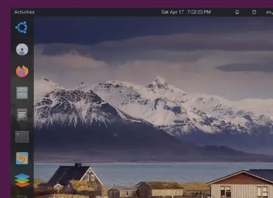

(3) Purple background... enter image description here

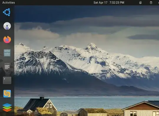

(4) Desktop "expanding"... enter image description here
(5) Desktop... enter image description here

You can see the default purple background by typing: $ gsettings list-recursively org.gnome.desktop.background which will print a whole lot of info, and the ones you are interested in are:
org.gnome.desktop.background primary-color '#2c001e' org.gnome.desktop.background secondary-color '#2c001e'
This '#2c001e' is the purple, and you can change it by typing:
$ gsettings set org.gnome.desktop.background primary-color '#3c39e3'
