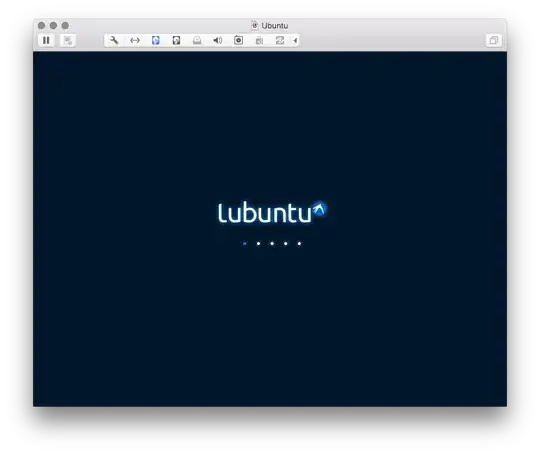

I am talking about the initial start up screen with incrementing anticipation dots during the boot. It says Lubuntu instead of Ubuntu. I'd like it to say Ubuntu if possible.
Where is this config file stored?
This is the screen I want to modify:
Necktwi
  • 1,087
If you want to change your boot screen, run the below command:
sudo update-alternatives --config default.plymouth
This will bring up a prompt where you can select which boot animation you want to use. Choose the ubuntu-logo entry, and hit Enter.
When you're done, update your system's cache using this command:
sudo update-initramfs -u
Upon next boot, your boot animation will be back to normal.
