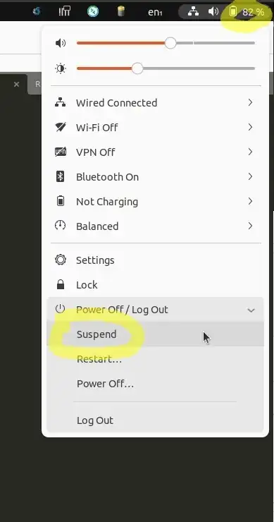

Via the GUI menus:
Running my command above produces the exact same result as clicking the top-right of your screen and going to "Power Off/Log Out" --> Suspend, as shown in this screenshot here:
