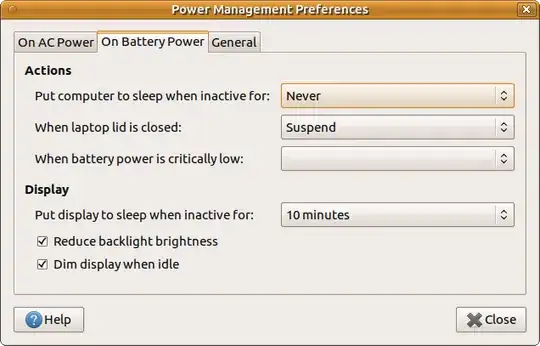

The MATE Power Management Preferences (mate-power-preferences) does not have GUI element to set critical battery level:
Where should I set critical battery level for hibernate or suspend from MATE GUI?

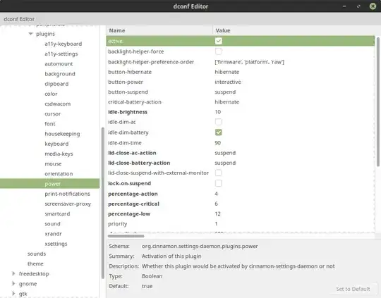

GUI method
From: Change Critical Battery Level and Action in Linux Mint 18 Cinnamon you can install dconf-editor using:
$ sudo apt-get install dconf-editor
Then go to org -> cinnamon -> settings-daemon -> plugins -> power
  • Default settings are (in %):
  • Critical battery action: hibernate
  • Critical: 2
  • Action: 2
  • Low: 10
Exercise caution and tweak to your heart’s content
