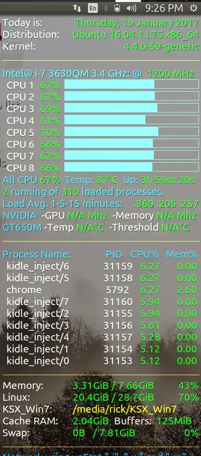

Powerclamp in action displayed by Conky
Here is a screen shot when Powerclamp injects sleep cycles:
Kidie Injection
Normally on this system CPU clock speed is 2400 Mhz to 3400 Mhz when watching HTML5 video and 10 Chrome tabs open. Normally CPU utilization is about 9% to 12% across 8 CPUs. When things get too hot (86C) Powerclamp kicks in and this happens:
  • CPU speed is reduced to 1200 Mhz.
  • CPU utilization spikes up to 80%. This is misleading because the extra 70% is sleeping time.
  • The top 9 CPU processes are usually 5 or 6 Chrome processes plus Xorg, Conky, Pulse Audio and an occasional kworker. However now 8 of the top 10 are the kidle_inject/x process where x is from 0 to 7. For the first 8 CPUs.
The Powerclamp driver runs until temps drop below 85C again. While the driver is running you might have split second pausing in your videos and possibly split second keyboard and mouse lag.
