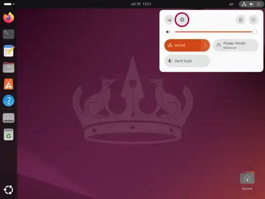

  1. Go to System Menu at the top right corner of the desktop panel and select Settings, the gear/cog icon.
    The Cog Icon

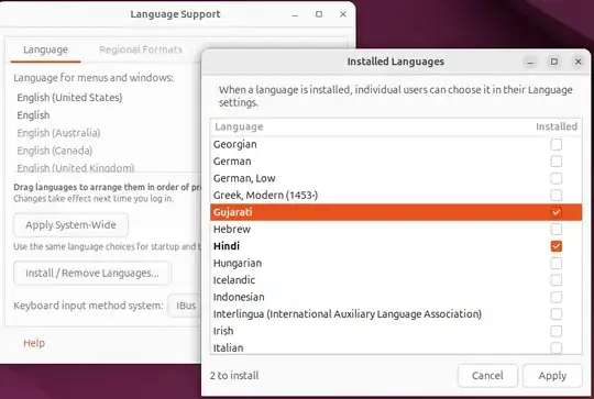

  3. Click on Manage installed languages under System. A new window will open

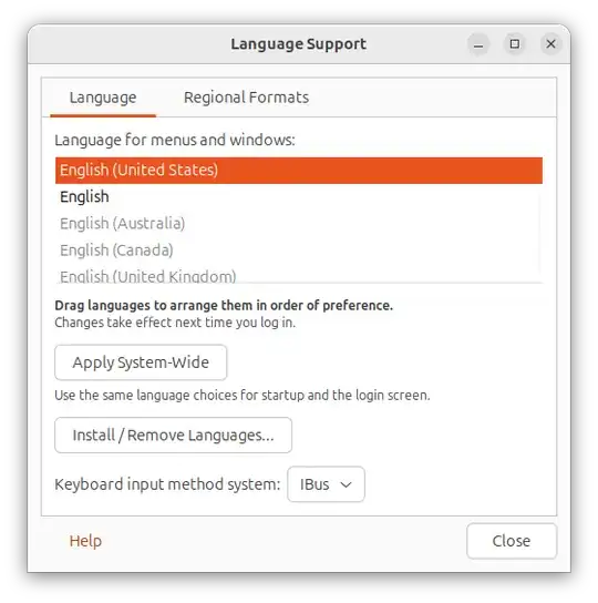

    Language Support
  4. click on the Install/Remove Languages... button. Another window will open. Scroll down and check the boxes for Hindi and Gujarati (and any other Indian languages you want). Then click the Apply button below. Installed languages
    You will have to enter your sudo password in the Authentication Required window. This will install the ibus-m17n language library.
Close all applications and restart the computer for the ibus-m17n based keyboard layouts to show up in the list.

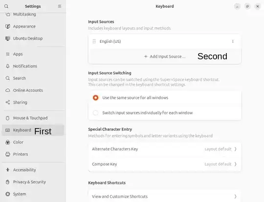

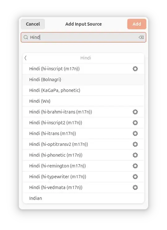

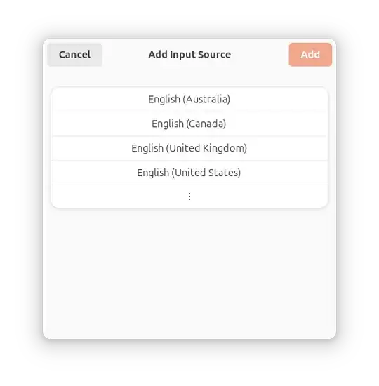

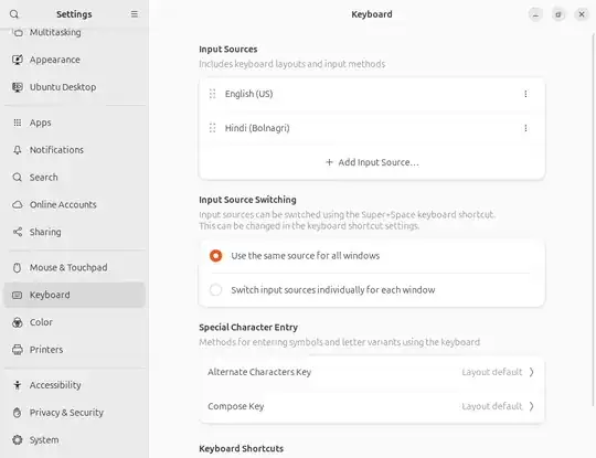

  1. Select Keyboard on the left panel first. Select + Add Input Source from the right panel. Add Input Source
  2. Click on the three dots at the bottom to show more languages. enter image description here

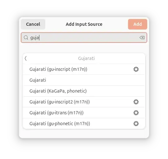

  3. Type Hindi or any other language you want to install. The word Other will show on the top of the Window.
  4. Click on Other different keyboard layouts for Hindi (or the language you typed) will show below it.
  5. Select a keyboard layout and press the Add button at the top. enter image description here

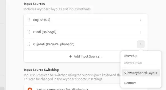

    Now the new keyboard layout will be listed in the Input Sources table. enter image description here
That's it!
For Gujarati and other Indian languages
Repeat the steps above.

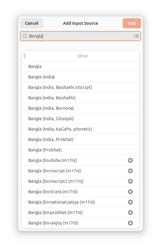

Here are the choices for Gujarati keyboard layouts: enter image description here
Other languages like Bengali has more choices:
To check the keyboard layouts of the languages you selected click on the three dots next to the language and then select View Keyboad Layoutenter image description here
You can also see the keyboard layouts of any installed language from the drop-down menu of the language icon on the top right corner of the desktop.

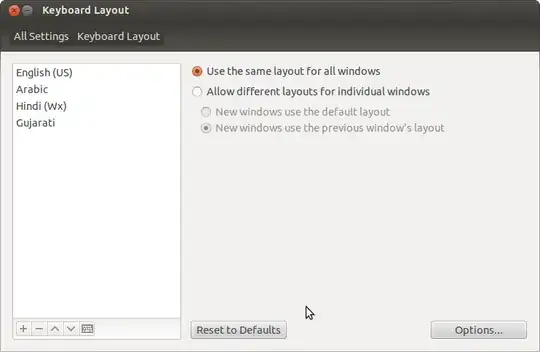

Using GUI open System settings, go to keyboard layout, and add the layout that you desire.

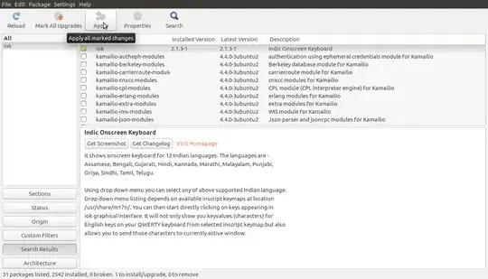

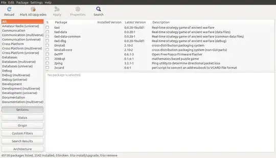

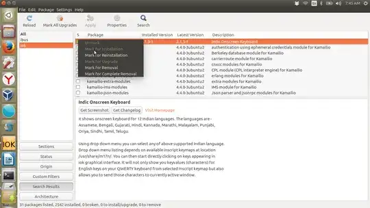

sudo synaptic
The synaptic window opens

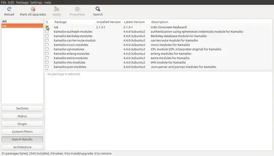

Go to the search tool and search for the package iok
In the window that appears tick the box left to iok

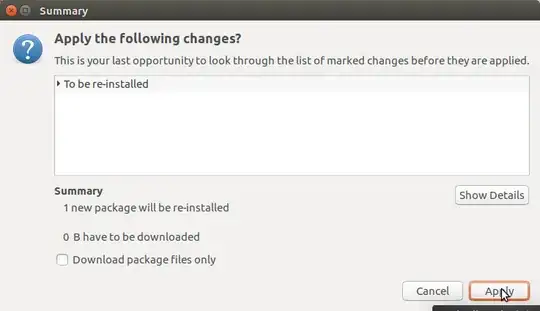

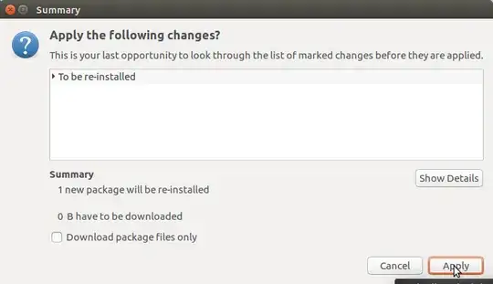

Click on mark for installation
Click on Apply
Again click on Apply
Click on Close

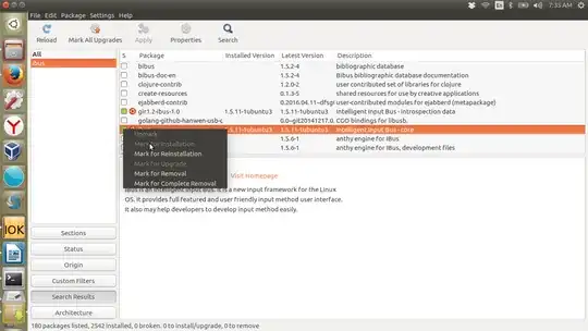

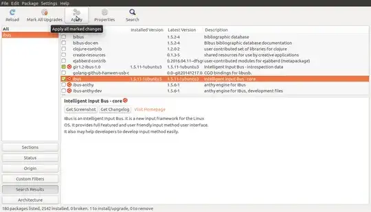

Now search for ibus
In the window that appears search for ibus and tick the box to the left of it
Click on apply
Again click on apply
Click on close

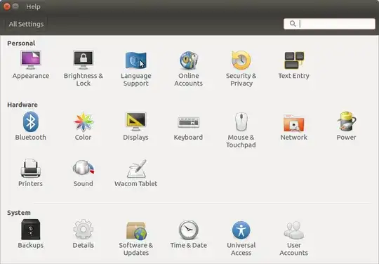

Go to settings

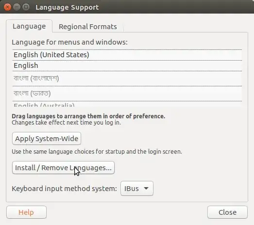

System Settings window opens, go to Language Support icon and click on it

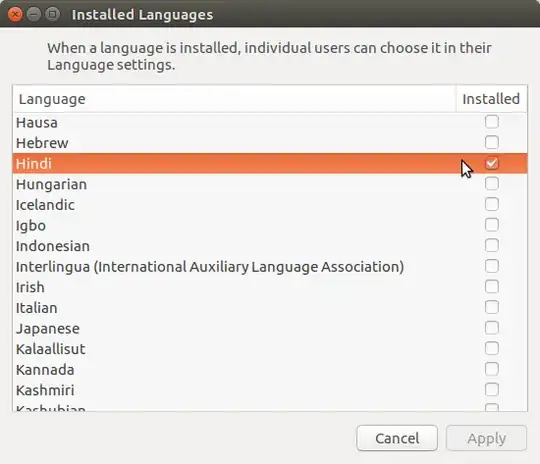

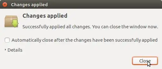

In the Language Support window that appears click on Install/Remove languages
Browse for Hindi and tick on the box right to it.
Click on apply
Close Language Support and System Settings Windows

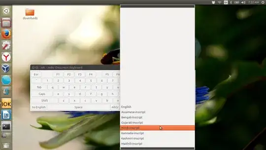

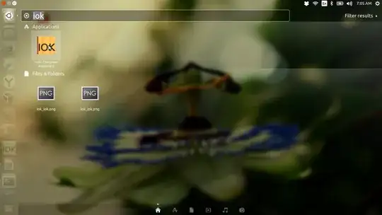

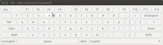

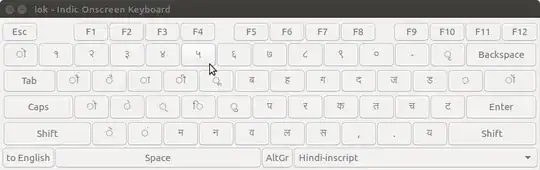

Type iok and click on the iok icon that appears
iok -Indic Onscreen Keyboard opens
In the Right Bottom select hindi-inscript
New keyboard layout appears
