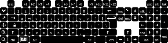

I am using CentOS with xfce now, but I think Ubuntu has the same package and properties.
  1. First add Indian keyboard layout to your keyboard properties and ensure that appropriate fonts are installed.
  2. Install package florence:
    $ sudo apt-get install florence
  3. Run this command so you can choose your keyboard layout (both virtual and real):
    $ florence
Keyboard screenshot:
keyboard screenshot
