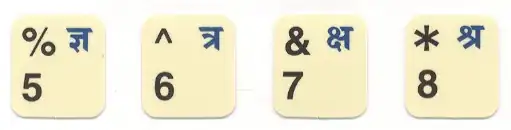

I checked that "Indian" board a bit. All the keys seem right except for the 5, 6, 7, and 8 keys are not mapped as shown in the images I found. So I do not know how you would access the characters normally accessible there.
Missing characters

श + ् + र = श्र
क + ् + ष = क्ष
त + ् + र = त्र
ज + ् + ञ = ज्ञ
You can combine existing words to form these. It is a bit lengthy but works..
