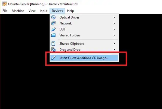

First, please make sure you have installed the Guest Additions
  1. Start your VM
  2. Devices > Insert Guest Additions CD image... Insert Guest Additions CD image...
  3. Mount the CD:
    sudo mount /dev/cdrom /media/cdrom
  4. Install the necessary packages:
    sudo apt-get install make gcc linux-headers-$(uname -r)
  5. Install:
    sudo /media/cdrom/VBoxLinuxAdditions.run

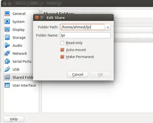

Second, add your user to the group 'vboxsf':
~$ echo $USER;
ahmed
~$ sudo usermod -a -G vboxsf ahmed
Reboot
Know that the label of your shared folder is lpi (for example):
Edit shared folder
Prepend sf_ to the label. Then, you will find your shared folder under /media/sf_lpi
Finally, you can also create a link to your home. For example:
ln -s /media/sf_lpi /home/ahmed/lpi
