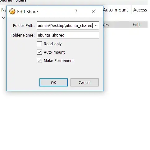

1- From Virtual Box, I went to Devices > Shared Folders > Shared Folder Settings, added a new Shared folder on my windows desktop named 'ubunto_shared' like the following:
following
