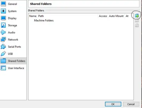

Let me share what has worked for me in two different setups, an Ubuntu 20.04 LTS Desktop and an Ubuntu 20.04.3 LTS Server on a Windows 10 host. I will use an example username sun. The first step is common, and is done via the VirtualBox UI (I have 6.1.26 at the time of posting), by selecting the target VM and going to Settings > Shared Folders and clicking the "Add shared folder" button:
shared folder settings
On the dialog box, I entered the Windows source path in "Folder Path", an arbitrary name for the shared folder under "Folder Name", and the "Mount Point" which is a valid path of my choosing, on the guest. Note that "somename" should be an empty directory:
