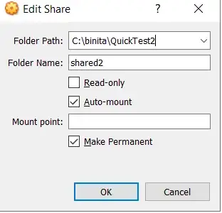

I think you missed manually creating and mounting the Host OS folder into the Guest OS. Here is how I got it working on my system. System configurations :
Host OS : Windows 10
Guest OS : Ubuntu Xenial
Virtual Box : Oracle Virtual Box 6.0
Created SharedFolder from the desired VirtualBox settings as given in below image :
Folder Path is the actual folder path on the Host OS. Folder Name is any arbitrary name you choose to have for your shared folder; it need not be physically present either on Host OS or Guest OS. Now, we need to actually mount the shared folder on the Guest OS. Run the following commands on the Guest OS, from the user's home directory : mkdir -p ~/shared3; sudo mount -t vboxsf shared2 ~/shared3 . Hereon, the ~/shared3 folder on the Guest OS will show same content as the Folder Path on the Host OS, and the folder will be readable/writable both ways.
