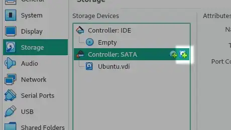

After shut down the new machine just attach the old virtual drive to it from the settings dialog:
In the next window choose add to have a dialog where you can browse to the location of your old virtual drive.

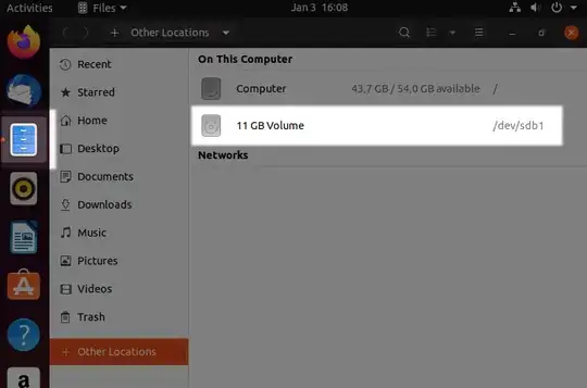

After rebooting the new VM (from the new drive!) the old drive will appear as a location in Nautilus ("Files"), from where you can mount it and copy the files to wherever you want (e.g. a network location, cloud storage or a shared folder).
Only in case your drive's filesystem was corrupt and mounting fails you can use data recovery tools on a copy of the VDI file.
