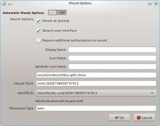

The GUI solution for me is gnome-disks
sudo gnome-disks
gnome-disks
Then with the configuration button you can "edit mount options", feel free to give the destination of your mount point and it will be saved into the /etc/fstab automatically enter image description here
Note: the nofail option that causes the system not to hang if this mount point is not available, could be useful in case of potential unreachable filesystem on boot such as USB, NFS, etc.

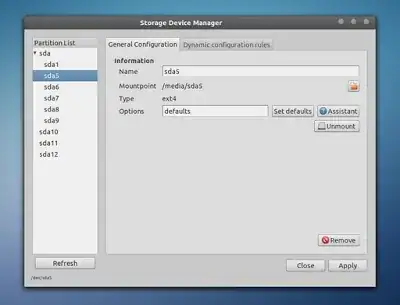

For those lazy and cautious ones who want to use a simple and self-explanatory GUI there is a tool called Storage Device Manager (pysdm). The tutorial here will do basically the same as other answers in this thread suggest to do, but the tool will accomplish it with a couple of clicks and no need to enter configurations manually into fstab config file.
sudo apt-get install pysdm(Ubuntu) or sudo yum install pysdm(Fedora)
Nothing should go wrong, but just in case, backup the fstab conf: sudo cp /etc/fstab /etc/fstab.old
Now run the Storage Device Manager and select your preferred partition, click "Assistant":

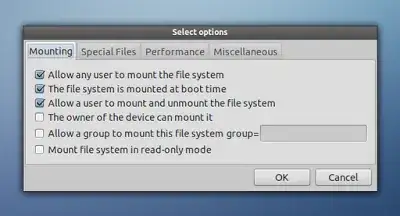

PySDM assistant settings for automounting EXT4 partition: enter image description here

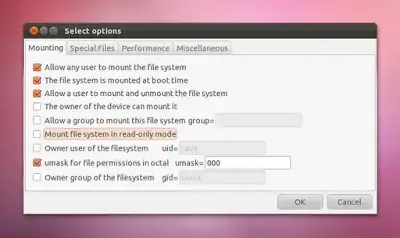

PySDM assistant for automounting NTFS partition: enter image description here
Reboot and see that your drive gets automatically mounted now.
