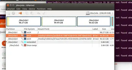

If you refer to my other posts, I am trying to use g++ and in order to compile a .cpp file I'll have to refer to it with the drive name:
g++ /media/drivename/filename.cpp
The problem is with the file path, as you see the drives are named so ridiculously with some random number group. I can't just type in
g++ /media/123414 14124 14 1/filename.cpp
I tried relabelling the partitions and turns out you don't refer to them with their labels but with their names and these names are based on where the drives are MOUNTED. As you can see in the below picture, these are mounted at this ridiculous location /whateverucallit. This is frustrating. I just switched to Ubuntu, and I'm having a really hard time here.
Example
The partitions were created after the ubuntu was installed and they were created with GParted. I have looked at other threads telling you to edit your etc/fstab there is no fstab folder there except a fstab.d folder and that too: an empty one.
Okay, my bad. It was talking about the fstab file. There is one here are the contents of the file:

Turns out fstab doesn't even mention the two newly created partitions. What now?.
UPDATE:
I added the following lines in fstab but since they did nothing, I've commented them out.
#device        mountpoint             fstype    options  dump   fsck
#/dev/sda3    /home/robbino/driv1    ext3    defaults    0    1
#/dev/sda4    /home/robbino/driv2    ext3    defaults    0    1
Here's the sudo fdisk-l output
$ sudo fdisk -l
Disk /dev/sda: 320.1 GB, 320072933376 bytes
255 heads, 63 sectors/track, 38913 cylinders, total 625142448 sectors
Units = sectors of 1 * 512 = 512 bytes
Sector size (logical/physical): 512 bytes / 512 bytes
I/O size (minimum/optimal): 512 bytes / 512 bytes
Disk identifier: 0x0001ec87
   Device Boot      Start         End      Blocks   Id  System
/dev/sda1   *        2048   206092287   103045120   83  Linux
/dev/sda2       617037822   625141759     4051969    5  Extended
/dev/sda3       206092288   415674367   104791040   83  Linux
/dev/sda4       415674368   617035775   100680704   83  Linux
/dev/sda5       617037824   625141759     4051968   82  Linux swap / Solaris
Partition table entries are not in disk order
