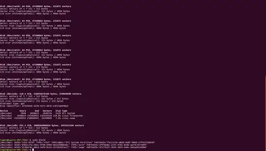

I have a clean install of Ubuntu 16.04 on an Acer Aspire VN7-792G that has a 128GB SSD and a 1TB HDD. The laptop was preinstalled with Windows 10, which I removed using the diskpart utility and clean (for the SSD) or clean all (for the HDD) commands.
The HDD can be found from the terminal with the fdisk -l command, but is not shown on the Launcher or in the "computer" window.
I'm guessing that the first stage to correcting this is to assign the HDD (disk /dev/sdb) a UUID, as it does not currently appear to have one.
fdisk -l and blkid results:
results of fdisk-l and blkid

Linux systems don't mount hard drives, they mount filesystems that live inside partitions or logical volumes on those drives.
In the case of ext2/ext3/ext4 filesystems, you can change the UUID using the tune2fs command. From man tune2fs:
-U UUID
       Set the universally unique identifier (UUID) of  the  filesystem
       to UUID.  The format of the UUID is a series of hex digits sepa‐
       rated          by          hyphens,          like          this:
       "c1b9d5a2-f162-11cf-9ece-0020afc76f16".   The UUID parameter may
       also be one of the following:
             clear  clear the filesystem UUID
             random generate a new randomly-generated UUID
             time   generate a new time-based UUID
       The UUID may be used by  mount(8),  fsck(8),  and  /etc/fstab(5)
       (and possibly others) by specifying UUID=uuid instead of a block
       special device name like /dev/hda1.
There may be equivalent commands for other filesystems.
However, based on your fdisk output, it looks like /dev/sdb is a bare unformatted disk that simply has no recognizable partition(s) or filesystem(s) defined on it.

UUID can't be assigned manually, as far as I know. It's generated algorithmically during a format, to ensure it's globally unique, and being able to change it to an arbitrary value would allow duplications.
Editing /etc/fstab can tell the OS to automatically mount a drive during startup. This preferably uses UUID to identify the drive. The existing UUID can be found with blkid or by looking in a partition editor (gparted or equivalent).
If the HDD doesn't show in blkid or in a partition manager, check that the data and power cables are connected to the drive, and motherboard as appropriate.
