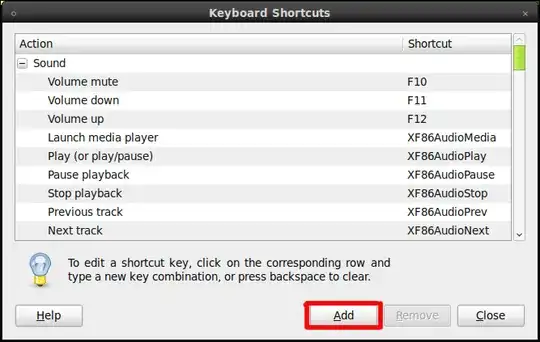

You can use the keyboard shortcuts interface to do this. Remember to add the full path. alt text
RolandiXor
  • 51,797
Goto System>>Preferences>>Keyboard Shortcuts

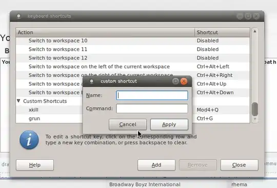

It will open a window click add alt text
After clicking add it will show you a window with Name and Command.You can write any name there and in command you should give the full path of the file with bash in-front bash /path/to/the/file.sh
alt text
After adding the Name & Command.You can assign the shortcut key.

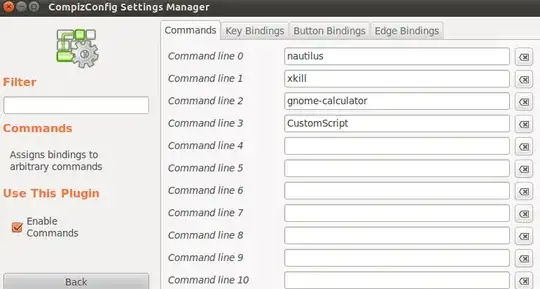

Just for completeness: If you are using Compiz you can set custom keyboard and mouse shortcuts using CCSM (Compiz Config Settings Manager) and the Commands plugin.
Just put in the name of your sh-script (for example "CustomScript" in the attached screenshot) and give it a custom key binding in the Key Bindings tab. Your script needs to be placed in a directory that is monitored by Ubuntu for this to work. I do place all of my scripts in the /usr/local/bin directory.
Make sure that your script is executable by applying chmod +x CustomScript in a terminal and note that all words are case sensitive.
Compiz allows to export all settings including shortcuts which is very useful for settings up similar machines.
(see screenshot)
