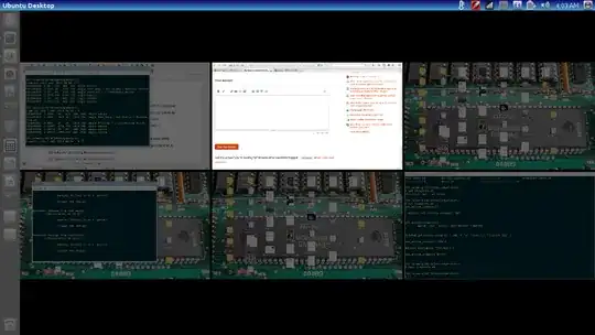

Unity : What are Viewports?
Ubuntu Unity uses viewports - basically a coordinate system (with coordinate 0,0 being top left corner) , where one giant desktop subdivided into chunks that fit your screen resolution. Coordinates grow in value as you move to the right and downwards.
The coordinate system is relative. If my current viewport is top left , everything relative to that viewport will be positive values in increments of width and height. For instance, if my current viewport is top leftmost, the firefox window in top middle workspace you see above is positioned in at x value 1366 and y value 0 relative to the top leftmost viewport. If my active viewport is top middle one, the terminal window in top leftmost viewport is positioned at x value -1327 60. This is the key issue for xdotool , because xdotool does not deal with negative numbers.
Note also that, the top left corner of your current viewport will always be assumed by xdotool as coordinates 0 0 . That means we can only move stuff right and down.
Making xdotool work for Unity
Now we know that xdotool can move windows only relative to our top-left corner ( i.e., you can always move window down and right , but never up and left ). How do we make that work for unity. Well, the basic idea would be to
  1. Figure out all the windows on current viewport
  2. Move to a requested viewport momentarily to make the top left corner assume coordinates 0 0 at that viewport
  3. Move all windows to user-defined viewport coordinates
  4. Return to the old viewport ( optional , could follow the windows as well )
