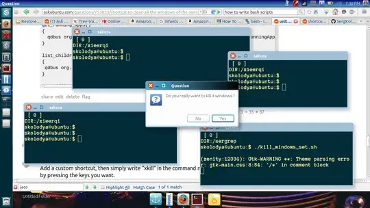

if zenity --question
--text="Do you really want to kill ${#PIDS[@]} windows ?" ; then kill ${PIDS[@]} fi
} main
Script in Action
