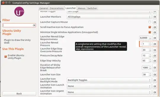

I run into the same problem, but in Ubuntu 16.04. Finally I found solution in Compiz. Set launch reveal pressure to 1. Hope it will help to somebody still. See the image:
