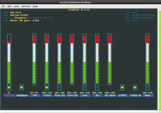

11
Yes there is type alsamixer in terminal
alt text
Press ,
F1 - Help
F2 - System Information
F6 - Select Sound Card
Esc - Exit the menu

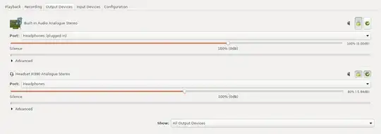

pavucontrol
Not the actual Ubuntu volume control, but better! It lets you control default devices, and even devices per application/stream.
You have to have the app actually be recording/playing for it to appear in the 'Playback' or 'Recording' tabs, but once you choose the device for that app, it seems to remember it forever.
