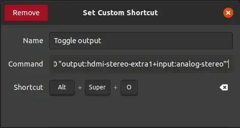

As said, on Settings → Keyboard shortcuts you can create a custom one to a command similar to:
bash -c '[[ $(pacmd list-cards | grep "active profile" | cut -d " " -f 3-) = "<output:hdmi-stereo-extra1+input:analog-stereo>" ]] && pacmd set-card-profile 0 "output:analog-stereo+input:analog-stereo" || pacmd set-card-profile 0 "output:hdmi-stereo-extra1+input:analog-stereo"'
Of course you should change the card profiles accordingly of those between you want to toggle.
screenshot
