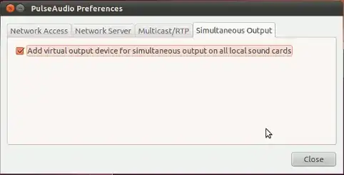

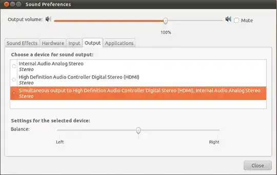

With paprefs you have access to a virtual output device that enables simultaneous output to all attached sound cards and devices:
sudo apt install paprefs
Then in the terminal run paprefs, select Simultaneous Output tab, and check Add virtual output for simultaneous output on all local sounds cards.
paprefs

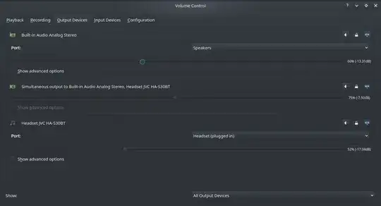

The additionally created audio output device for simultaneous output may be selected in the Output tab from the PulseAudio Sound Preferences menu (pavucontrol):
pavucontrol screenshot
In this example it is shown for an HDMI-device, but, as soon as your Bluetooth device is recognized, it will also be available for simultaneous output.

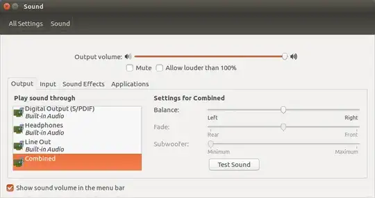

I've just confirmed this solution still works on Ubuntu 14.04 LTS.
  1. Install: Open terminal and type sudo apt install paprefs go to the tab exactly as per the picture above and select the option.
  2. Initial Run:
    1. Remaining in terminal, type pulseaudio -k to kill and restart pulseaudio (this way with current systemd pulseaudio user service).
    2. Then go to your sound settings and you will see the option to output to multiple sound devices.

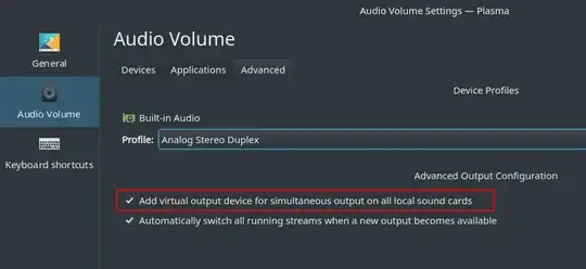

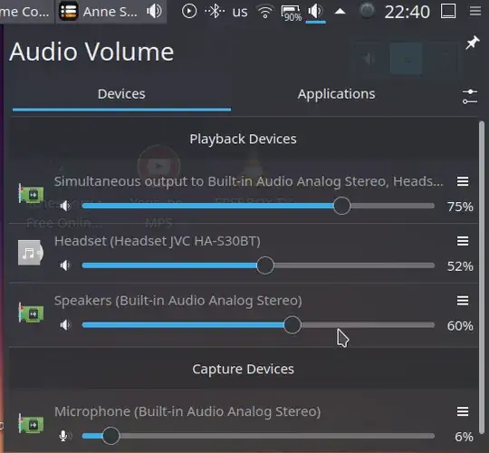

In Kubuntu 18.04, Plasma 5.12 paprefs is not needed, as a similar setting is already there:
A new output option should become available after reboot, called “Simultaneous output”.
Or in pavucontrol:
In 18.10 with Plasma 5.13.5 that “Simultaneous output” option has been removed, so paprefs is needed.

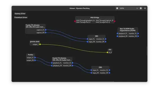

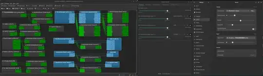

Nowadays
Actually, with pipewire, just the GUI part seems to bee missing for this to work (in GNOME, as of GNOME 45).
Actually, there are many GUI tools for this and similar tasks (like distorting audio or so), just search for pipewire on Flathub e.g..
I tested some and found Helvum to be good and working for that use case.. In the self-proclaimed “graphical patchbay for PipeWire”. You can just connect the same source twice there or mix that up even more: .
I.e. drag and drop the source from the left to the right, where the audio devices are. (Note FL is left audio and FR is right audio) The disadvantage/important thing to note is the source only appears once it has audio output and you need to configure this for each application. (though, the benefit of course is, you can configure it separately)
The benefit is this also works on immutable distros.

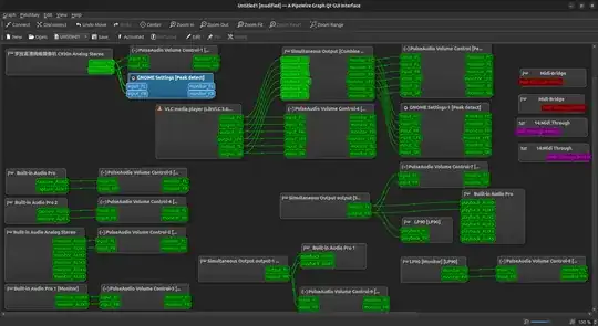

For Ubuntu 24.04

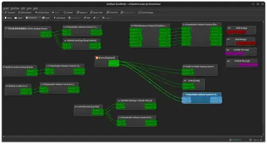

I recommend using qpwgraph since pipewire is installed. It is a GUI that allows a user to graphically make the necessary audio(+video) connection/disconnection without any coding involved. For example, below picture shows how I could connect VLC to the “Simultaneous Output” audio device created by @DidierL then from that device to both the Built-in Audio device and a bluetooth speaker(i.e. L90). No coding skill required. Very easy to do.
vlc
The next picture shows how I could do the same by directly connecting youtube in brave browser to both the Built-in Audio device and a bluetooth speaker(i.e. L90) without involving a simultaneous audio device. youtube
Below picture shows the the Simultaneous Output device connected to 3 speakers (1 built-in and 2 bluetooth types):
3speakers
