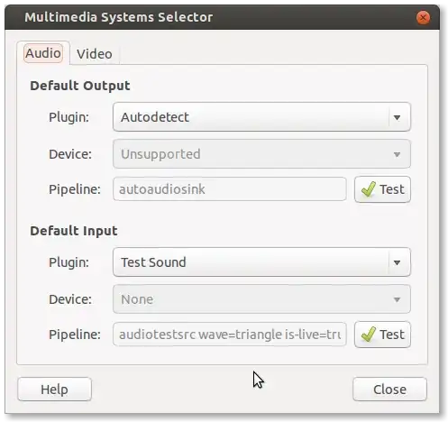

On the Dash, search for Multimedia Systems Selector.
Open it and in its Audio tab you can select the default audio Input and Output devices.
This application is installed by default in Ubuntu Installation. But if you haven`t this somehow can install by
sudo apt-get install gnome-media
If it is not shown in the Dash, run:
gksudo gedit /usr/share/applications/gstreamer-properties.desktop
In the resulting text file, go to the line starts with NoDisplay=. Change the NoDisplay=true to NoDisplay=false

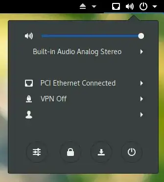

If you're using a newer 3.x gnome, show your launcher (default windows key) type settings -> sound. Select a different default, close the window.
Picture of the select sound window
Firstly, thank you to user224082 for your solution which helped me discover which device I needed.
To find which ALSA device you need:
  1. Using Multimedia Systems Selector, choose ALSA — Advanced Linux Sound Architecture for Plugin
  2. Test the different options under Device until the desired speaker is selected
  3. Make a note of the device= value in the Pipeline box. Mine was "hw:0,4"
Once you know which device you need, set it as the default:
Edit default.pa by typing sudo nano /etc/pulse/default.pa
At the very bottom of the file, add:
load-module module-alsa-sink sink_name=spkr device=hw:0,4
set-default-sink spkr
replacing the device= value with your device.
