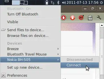

So even though the headset is paired ok and would in "normal" scenario autoconnect, I have to always use the little bluetooth icon in the notification area to actually connect to my device (see screenshot).
What I want to avoid: This GUI for connecting to a known and paired bluetooth device:
Connecting to Bluetooth headset using icon
What I want instead: I'd want to make the bluetooth do exactly what the clicking the connect item in the GUI does, only by using command line. I want to use command line so I can make a single keypress shortcut for the action, and would't need to navigate the GUI every time I want to establish a connection to the device.
