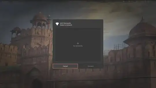

ant_sel=1 doesn't gives any noticeable change
ant_sel=2 results in 'no network found` (Ubuntu unable to find any wifi network)

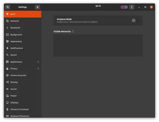

  2. Stay's like this enter image description here

  1. ant_sel=2
parag@Notebook:~$ sudo tee /etc/modprobe.d/rtl8723be.conf <<< "options rtl8723be ant_sel=2"
parag@Notebook:~$ cat /etc/modprobe.d/rtl8723be.conf
parag@Notebook:~$ iwlist scan | egrep -i 'ssid|quality'
lo        Interface doesn't support scanning.
enp1s0 Interface doesn't support scanning.
                Quality=64/70  Signal level=-46 dBm
                ESSID:&quot;FTTH-5731&quot;
Outputs:
No wifi network was found in setting -> wifi
