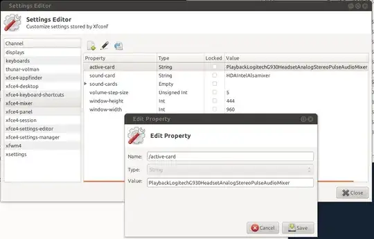

This fix will also fix the volume control on the Logitech G930 Wireless gaming headsets. (Not sure about the other buttons though) Launch Settings / Settings Editor (not the normal Settings Manager) or open a command prompt and type xfce4-settings-editor
Then, under xfce4-mixer And replace the active-card setting marked Value: to
PlaybackLogitechG930HeadsetAnalogStereoPulseAudioMixer
I've included an image to make it easier to understand
Also if have problems with the headset volume working here's a link that may help https://bugs.launchpad.net/xfce4-volumed/+bug/901338
Basically do a killall xfce4-volumed and try moving the volume on the headset again
