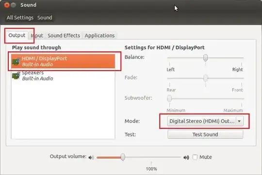

Have changed audio source in sounds settings after connecting to TV ?
see below image for reference. you need to change it to HDMI/digital Stereo.
refer_this
